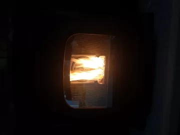

Performance feedback: with storm Titan approaching New England our overnight was much higher (32 or so) than prior 3-4 days so I was curios what the same room temp setting would provide as I have a cathedral family room (no doors). When my son, the 3yo, woke me help him blow his nose at 530, we walked downstairs.
Room temp medium, temp 75, feed 3--- actual room temp 75.
