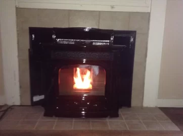

[Hearth.com] Harman Accentra 52i
  • [Hearth.com] Harman Accentra 52i
O[Hearth.com] Harman Accentra 52i
Congratulations !
