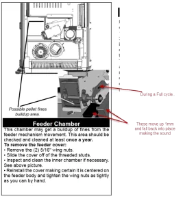

Bought a used Harman Accentra-2 and this is the first season running it. The whole thing worked nicely until a new very suddle noise was starting to occur. The pellets are entering the auger and being fed into the burn pot. It just seems that something is loose in the back.
Feeder set to 2(turned down from 4 per startup instructions), Room Temp, Temp set to 75degs. I also switch the ignitor back over to manual. Is leaving the system on auto the entire time ok?
I first noticed this noise last night while the stove was running. I don't have easy access to the back of the stove it's close to the chimney mantel. I pulled off the left rear panel where I have access to clean out the fines and there were fines behind the panel, but didn't look alarming. After closing and starting up again, the noise continued. See attachment for visual from manual.
What I am seeing is the motor being lifted and setting back into place 1mm of movement. I can put my hand on the chainbox and it won't move during the cycle and no noise.
Looking at the manual, feeder assembly, I see a "3/4 Feeder Tensioner". Should I adjust that, and in which direction?

I'm assuming you have the chain drive model. Put the stove in test mode and watch the auger/feed motor for anything unusual. The chain should be aligned and moving smoothly. If there's a misalignment the chain my not ride on the sprockets smoothly. There should be a slight amount of slack in the chain. The chain rides on a nylon bushing which can be adjusted up/down. Loosen the bolt thru the nylon bushing to adjust the slack in the chain. I apply a light amount of high temperature grease on the chain and sprockets to keep it moving smoothly and it also reduces the noise.

There's 2 different versions of the Accentra stove. One has a chain drive and the newer model does not. The newer model, as shown above, is the direct drive model and has no chain.
That video I posted shows a direct drive motor? It's what I have. The manual is very generic then.
Good news. After that complete feeder cleaning, carbon scrapping around the auger, and testing. The stove is running better than before.
Other than that clunk, there was a slight whine to the motor that is no longer present. Next time, I'm looking the gift horse in the mouth.
I'm also running my pellets through a sand sifter to get the extra fines out before putting them into the hopper.
All parts look great. Wish I knew it just needed a cleaning.
