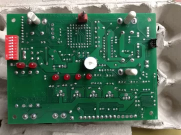

Thanks for info I don't see any switch could they be behind panel??
Yeah, you need to pull control panel. Here is what the board might look like...this was the board I eventually replaced. Looking at the upper right area the dip switch is on the other side.

Here's the back side, showing the dips:
