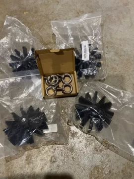

I did make some progress with some stuff I went and bought, but I can't use it again because it was too tight and almost didn't come back out.
But I did widen my hole twice as large as the plumbing auger. And probably enough that the stove will run just fine. But I really would like to get it completely clear, so that new ash doesn't have a lip to hang up on .
It's gotta be something that will break up really hard stuff.
Maybe there is a longer thinner extension for a drill with a locking end and I could get the larger step drill bit onto it. Because the larger step drill bit fits into the tube, it's just the extensions I had are too wide.
Here is what I did so far:

I am all set now to use these brushes on my exhaust with a rope. They come in different sizes, and you might be able to make a 90 bend (after it's clear).
