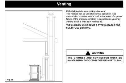

According to the installation manual it's perfectly acceptable, as long as the masonry flue is in good shape and has an appropriate sized liner.
  • [Hearth.com] Harman Accentra vent pipe installation
It really depends on the size of the existing tile liner and also local code. If the liner is too large there will be a condensation problem and possibly some creosote issues. The interior of my fireplace chimney for instance was 8x11 more or less so I dropped a stainless 4" liner down it. People do run through existing 6" liners though in some cases. Local code and or inspectors opinion supersedes everything, though most inspectors will go right by your install manual..
