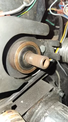

Not sure you understand what you are looking at. That bolt will wobble around with nut and sprocted removed. It is attached to the auger by the set screw, and the whole mass is turned by the sprocket.
The auger shaft was turning freely last night. It's seized now. I've taken the retainer off and have the shaft exposed.

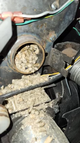

Not quite sure where to go from here. I pulled it apart as far as I can get to it. I'm having trouble taking out the auger itself. I can't get my wrench in the to pull it, the bearing around the shaft does spin a little.
I emptied out the hopper and vacuumed everything I could see.
On the older machines, they used to put silicone sealer around the bearing housing, where it slides into the stove. Can be a bugger to get unstuck!. You may have to use a thin chisle or screwdriver, to get between the bearing flange and stove housing, along with a mallet. Or try turning the bearing housing with a pipe wrench.
Got that part loose I believe. Still can't get auger to budge. Might try prying it with a flathead.

AH! Well then something bad inside there! Pry it out, only way to repair this stove!. Perhaps a chunk of metal or plastic, perhaps carbon from "gummy stove" syndrome!

From inside the stove use a punch or a long screw driver and hammer. Put the end of the tool on the end of the auger shaft and give it a few light/medium taps and the auger will unseat in the back. I usually use a long straight blade and use my channnel locks as the hammer because that is what is in my tool bag. . It dont take much to tap the silicone loose. No silicone needed when reassembling. When reassembling, snug the bolts on the flange collar then a few taps on the end of the auger from the back then check snugness of flange bolts. Turn auger by hand a few times to be sure it is centered and not rubbing. If it is give it a few more taps and recheck. I have had many augers out using this method. Also the female threaded flange nuts will sometimes drop out. Just but back in.

If you have something jammed in the auger you may have to use channel locks or vise grips on the rear shaft working it back and forth to dislodge before removing auger. Alot of times turning the auger backwards a half a turn will dislodge what is stuck in there so it can be pulled out to remove the object. I have found plastic chunks, kids toys, christmas decorations pen caps, nails, small bolts ect in the auger. Seems more common when the homeowner has the pellets in a tub as opposed to pouring out of the bag directly into the stove. Typically grandkids are to blame. :) I have not had one jam to where I could not get it out
