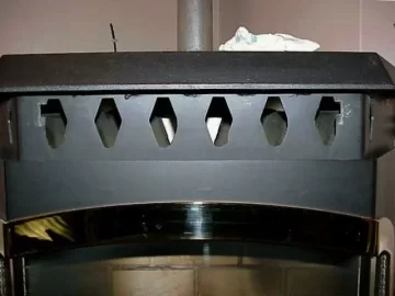

My dealer faxed me a copy of the modification that should be done to correct the smoke in the hopper issue,
2 holes are to be drilled 1 above the auger the other next to the air intake and a tube goes in each hole, He said that should solve your problem? See if you have the tube modification also?

Cut holes that I refered to in original post. Hope the photo shows up here.

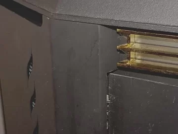

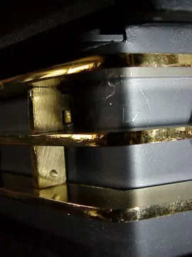

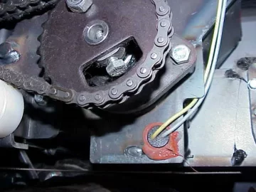

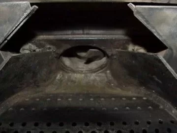

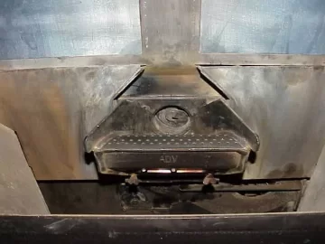

Grill fit....grill falls off. Under auger looking for etched "2". Auger "wing" tip. Size of burnpot.

Wow! The boys in Quality Control must have been on a coffee break when that stove rolled by! Sorry, I know it's not funny but that's just piss poor workmanship! Sort of makes you wonder if the outside is that bad what the heck the workings look like. I sure hope the same guy who cut those holes didn't also do the welding!
I'd be making someone get me another stove or at least getting a partial refund because that's a "second" if I ever saw one and you shouldn't have to pay full price for it. Yes, you could likely file the cut outs and make them look better and you could fasten the grill on so that it doesn't fall off and you could even live with the bent hinge but.......why should you have to? I'm sure that you paid good money for the original stove, those aren't inexpensive stoves, and IMHO you deserve what you paid for, a top quality stove that works!
I've got to admire your patience. You've been a lot nicer about all this than I would have been but I think it's time to take the gloves off.

What I need is other harman advance owners to take a good look at their stoves and compare them to my pictues and state that they think the workmanship on my stove is shoddy.
I have a Harman Advance for 4 years now and never had a problem. I think it is a great stove. In regards to the cut holes for the air distribution, I think the holes are actually laser cut so they're consistand every time, looking at my stove it appears the welder was the problem and actually had to much heat when he was welding around the holes.

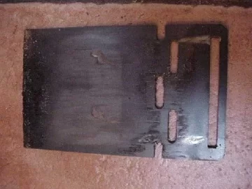

It got a major cleaning last Saturday, the next day I got the first smoke in the hopper. Pulled the slide plate and it was gunky. Here's a picture of the slide plate.

toastyinri, What brand of pellets are you using?
Thanks, another member was told there is a correlation between your problem and NEWP red letter pellets.
Call your dealer and tell them your slide plate is getting covered with the sticky stuff…

Have already done that and have also sent photo's and descriptions of my issues. I have two Harman dealers backing me up. ( My original dealer, the one I bought stove #1 from ... the same one who installed the replaced stove ,and the newest dealer in my area who really doesn't know enough yet about Harmans to offer a theory.) My original dealer is no longer carrying the Harman Line but will continue to service and trouble shoot the ones he has sold.
My original problem with both stoves is smoke in the hopper and the build up of gunk on the slide plate seems to tie in with it. My original dealer has offered a theory on why it could be happening. One theory is that the stove could be sucking in air from the back from a bad seal or weld. I guess the extra air getting into the auger tube and the heat of the running stove gets the pellets in the auger tube and pellet chute really hot and causes them to smolder or ignite back there. (something about positive and negative pressure...all greek to me) The first stove would push out charred pellets after a series of hopper smoke. The new stove is not doing that yet. (gaskets on hopper door and glass door are tight) Could it cause a fire in the hopper? That would be really ugly.
