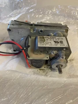

Has any one had luck repacking the auger motor gears with new grease to quiet it down? Thinking of trying it this preseason

If you do don't over pack it and don't use the same grease u use in your car, Usually they are packed with a light coating of white grease. If you pile the grease in their thinking its going to work better it will have the opposite effect and make the motor work harder.

Use a high temp synthetic grease and as stated above, don’t overpack
