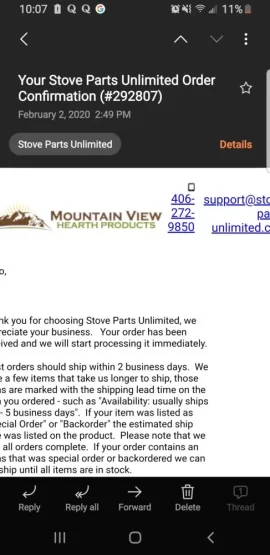

My stove dealer would do the same so bought online. 89.00 i think. Bought there before. Think it was mountainview energy something like that.OEM

By the way I paid $87 from Mountain View energy and my dealer wanted $122 so I see what you mean.
