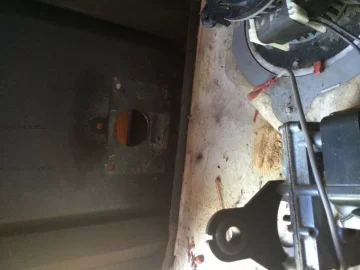

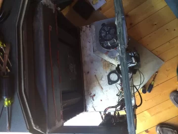

I posted over the weekend in a different thread (I should know better and Bioburner b*tch slapped me;)) with my phone but its so much easier with a PC so here goes. My Harman Invincible has a crack in the feeder tube weldment where the auger is and I was looking for advice as to how to get it out of the stove. Well it turned into a major disassembly of the stove. Anyway, I'm looking to source the weldment. Its $400 shipped from stove parts unlimited and $350 plus shipping from Nevel stoves. Does anyone have any other sources for older stove parts? Thanks in advance.

Any reason not to have just have it welded and polished?
I was gonna say once its out find a welder have him fill in the crack then grind it flush.

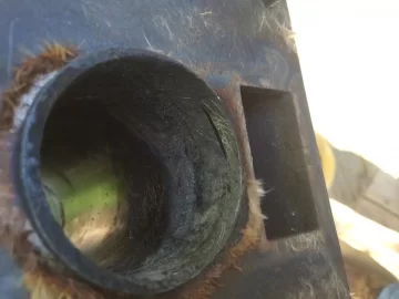

I'm definitely considering that. Its hard to see in my picture but half of the "face" of the weldment is gone, probably from 18 years of scraping the burnpot. Don't know whether that affects the functionality of it or not but I don't want to put it all back together to find out that it does.....
If you click on the middle picture you can see that the flat face is clearly there on the left side but is essentially gone from about 1 oclock to 6 oclock
I wire feed welder can layup a few layers quickly and be ground back to like new. If worried about carbonizing of the weld, could layup with stainless but a standard wire should last as well as the original.
I dropped the weldment off at a buddy of mine's shop who does superior welding and he said it would be no problem. Hope to get it back in a couple days....

I was polishing the auger last night. Amazing condition given the age of the stove. New burnpot gaskets are definitely happening. I just did the dist and comb blower a couple of years ago. But yes, everything that is even close to being needed is going to be replaced. This thing is WAY apart...much more than most DIYer's would probably try.
Hard to believe its 18 years old. I just finished putting her back together. Quite the job but it beats the price of a new one. Gonna have a couple if brewskis with some friends and fire it up later. Everything works as it should on test. I want the silicone to dry a bit (broken image removed)
