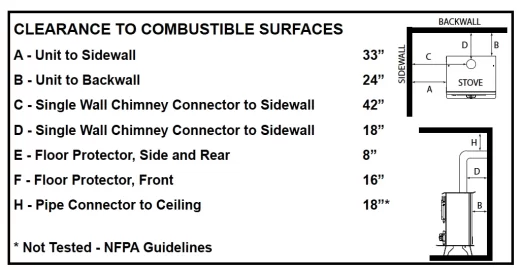

The manual says 24" rear clearance. With a proper, ventilated NFPA 211 wall shield, the least distance is 12" from the wall. Make sure the bottom of the wall shield is 1 to 3" above the hearth and open at the top for good ventilation behind it. You may find a lot more info on this stove over at the forum on www.nepacrossroads.com.
"Safe stove clearance to combustible
walls is 24” to the rear of the stove, and 33” to the sides of
the stove. In a corner installation, you need 24” to the side
walls. Clearance to the front of the stove, for furniture, etc.
is 36”."
