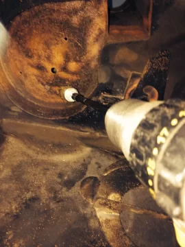

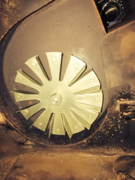

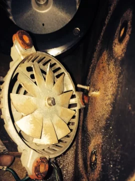

This is a 12 y/o Harman P61 that I updated to a P61a-2 with the original combustion blower. I tried the PB Blaster and wire brushing but no luck this time?

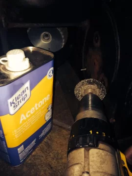

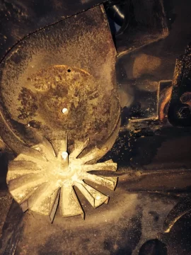

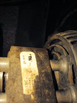

I could get the 3 screws out so I took out the saws all with the longest blade for the shaft. This was a wood/metal blade so not sure if it would work. The all metal blade was way too short!
It took a little longer but it worked!

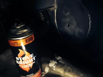

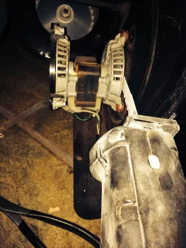

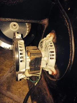

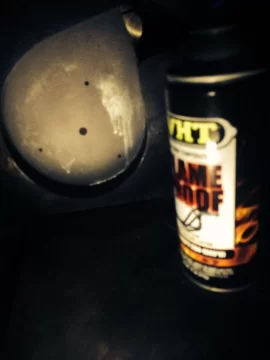

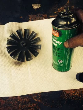

1. Remove 3 nuts on blower
2. Cut shaft with sawzall
3. Wire brush area behind blower
4. Wire brush area behind fan blade
5. Clean both areas with Acetone
6. Spray paint stove where blower was with Stove Bright Satin Black
7. Spray paint behind double paddle fan blades with VHS flame proof Flat Black
8. Clean and paint piece that goes over blades with Acetone and VHS Flame Proof Flat Black
9. Prep new blades with Dry Moly Lube
10. Install new Gleason Avery 1.75 amp upgraded blower and new fan blades
See pics

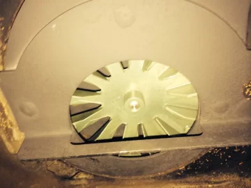

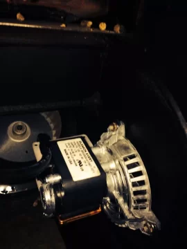

Here are 2 more pics
How does it look?

Looks great. I had misread your original post...just realized you said "set" screw. Sorry.
That's ok, glad you got yours fixed too! How many amps is your combustion blower? It should say on the tag.
Says 1.75. My old one had a bad bearing so swapped out under warranty.

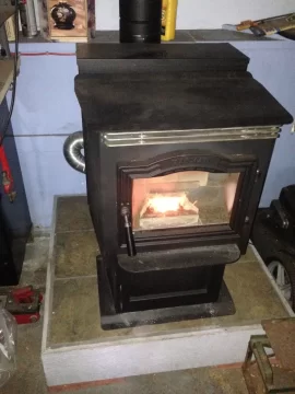

Thanks for letting me know, Now my 12 y/o garage/workshop Harman P61a-2 works as good as yours! Still has the original auger motor. :)

When we come up against stuck set screws we just drill em out and start again.
In this case getting the drill in the stove to drill is impossible. The blades must come off first to get the exhaust blower off the stove .
Different design which i found to be a thorn in the side(only when unable to remove the fan blade)!
if you can see the threads, next time light a candle and pour the hot wax over the threads. The liquid wax will penatrate down the threads and loosen up any rust.
Also, that set screw probably has some loctite from factory. a little heat will soften the loctite up.

I would use a dremmel tool with a grinder wheel on it. Less effort and probably faster than a saws all.
True but I found on my other Harman if the blades are removed once a year and cleaned, then they come off easily. :)
This year one of the blades separated, so I upgrading to the blades that are all bonded tog
How do you get the Dremel tool behind the combustion blower to cut the shaft?
  • [Hearth.com] Harman P-Series - Combustion Blower set screw stripped cannot get fan blade off for cleaning? #%&!!
Oops, not enough detail. I wouldn't cut the shaft with the dremmel tool, I would grind out the steel collar and set screw then pull the fan blade off.
Believe it or not, I tried drilling and grinding out the set screw and it does not always work. The best way in going that route is to fire up my die grinder and cut the blade collar down next to the shaft without hitting the motor shaft. That works great! The blades are junk but you can save the motor that way. Again on a Harman that may not be possible to get the tool into the stove todo it.
