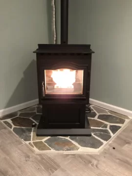

So I recently had a Harman P43 installed in my basement. I had an OAK kit installed as well and it is run with the usual flex pipe. Of course being a basement install the flex pipe is visible and the wife thinks it’s ugly at wants me to make it look more pleasing to the eye. I had originally intended on fabricating a replacement for the flex hose out of auto exhaust but got to thinking of another option but not sure if it would be legal or safe.
The oak kit originates at my foundation wall than comes in throug my dry wall next to stove pipe thimble than hangs down to the stove. I have a hollow stud cavity as my basement was insulated before it was finished. Could I legally run the flex pipe in side the stud cavity so that it exits the drywall behind the stove and is hidden rather than have it hanging down next to the stove pipe?

Legally depends on your local building codes. I don’t think it would be an issue. Another option wo be to enclose/box it in , to make it look better.
If it were me I would run the flex pipe
in a chase behind the drywall.
But check your building/fire code first
so if anything happened your insurance would cover you
spray paint it black so it matches the other one.

Why not just use 3" vent pipe, and spray it stove black?
It will match your other one...

Thanks for the response, was hoping some one might have done it already. I have an inspector coming out so I will ask him when he comes. If it’s not legal I think I will go the automotive exhaust route and weld it up. My installer was going to do it pvc for me but wanted $ 200 extra to do it. Travelers insurance requires it to be installed by a certified installer and pretty much took me for a ride on the install and I thought that price was ridiculous. Couldn’t believe they wouldn’t let me install It and have It inspected by the county.

I personally wouldn’t use PVC. I would think, in the event of a power failure, it would be possible, although unlikely, for the stove to pull air from the vent, and exhaust through the air intake. Probably not the best thing from a safety standpoint. Over cautious......maybe. Jmho
I'd be concerned about the piping inside the wall, in the unlikely, but possible, event of fire getting into the OAK. That is why we use metallic tubing in the first place.
