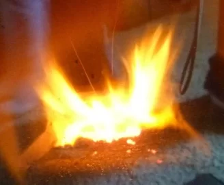

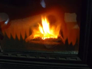

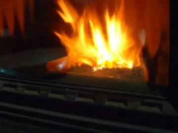

[Hearth.com] Harman P68, Dancing pellts in burnpot[Hearth.com] Harman P68, Dancing pellts in burnpot[Hearth.com] Harman P68, Dancing pellts in burnpot
*update: 3rd pic shows huge red pellets toward the front that have been blown off the pot and landed back on it. These litter the bottom of the ash pan.
Forgot to add, the first Pic is what it normally burns at , the 2nd pic is during feeding. I will be posting a video shortly. It will have normal burn with feeding halfway and at the end it will show a pellet spring out from the pile and land to the left on the burn pot. Not exactly what i was trying to show but close enough. Cant really see the dancing well in the video. Some happens int he center of the fire line but the fire glare washes it out mostly.

That is one sharp tongued fire. I've done a short term trial of of plugging holes with a cut down tight fitting nails. Easy enough to pull out if the idea does not work and good enough to leave in. There is a little bit of exaust fan adjustment +- 10 percent on the board.

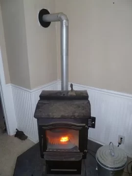

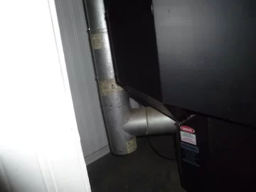

I honestly don't know anything about the venting. Be easier to just take a picture of it and you guys could probably break it down better then I ever could.
