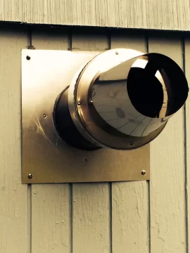

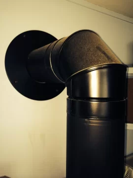

You may want to think about the Selkirk Direct Temp (DT)
You only need one hole in the side of the house. Not only does it make the stove 10% more efficient but with the vacuum cleanout Super Easy to keep clean and less caked ash in the burnpot!

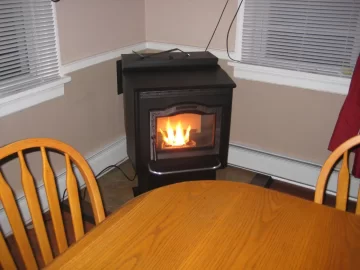

we paid 5,000.00 for a Harman P61A Which included install, exhaust and OAK, MetalTrim Kit, floor pad...November 2013............
