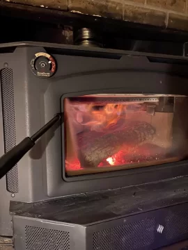

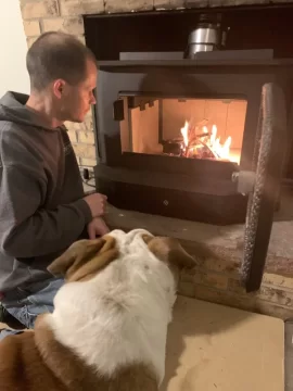

After 7 years in my current house in Longmont Colorado, I finally removed our old slammer stove and installed a modern wood burning insert: a Regency i2450. It’s been three days and I’m loving it! I had it professionally installed with a proper liner installation.
The old slammer:
See photos below. It was huge, and we only ran it 6 or 7 times in the 7 years we’ve lived here. It was difficult, and didn’t put out a lot of heat (not into our house at least!), so we gave up on it. I found out from the recent installers that it was kind of dangerous too. No liner, No stub from the exhaust of unit to the damper, and nothing to keep the damper from slamming shut in the wind.
Regency i2450 insert - initial use review:
I’ve been running it for three days now. I broke it in with three fires: small, medium, and medium/hot. The off-gassing was BAD. On the 2nd break in fire (medium sized), my house filled up with a haze and I got dizzy. I had several windows open initially, but I had to open EVERTYTHING. Front door, all windows, sliding glass door, etc.. The third fire had a little off-gassing, but was minimal.
I’ve had a couple of post break in fires, but have not raged it yet. Honestly, it puts out a ton of heat with what I would call medium fires. It’s in the basement of my 1900sq/ft split level house, and it keeps the whole house warm. It was 15deg F outside last night, and it was able to keep my house at 70deg F, with the electric fan on LOW. I have modern windows and a mediocre level of insulation. Early 70’s house in Colorado.
All in all, Im super impressed with the unit. Im curious to see how well it can heat my house without the fan on (in the event of a power outage). Will be testing that soon.
Im still waiting on the faceplate, and will be doing some light renovations soon to add tile, mantel, trim, cleanup, etc.
