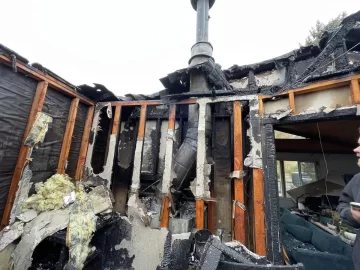

This fire happened yesterday to a friend's daughter. Her RING device alarmed her of CO2 and smoke detection. The fire dept. came out at 2am but never came in the house. At 7am, this happened.
This fire took 40 yrs. for pyrolysis to finally make it happen. Fortunately the fire dept response in this case was swift.

Uggh. Looks like a fun mess to clean up. Glad to see the structure appears to have been saved. Assuming everyone came through it okay?
All made it out ok. It's too early to know what their options are for rebuild or loss. I don't think they have a lot of money and I'm not sure if insurance is going to cover this. They just moved in last year. It looks to me like the previous owner of 70 yrs. at one point cobbled on a different chimney and put a large storm collar over the original air-cooled chimney, thus blocking off its convective cooling. This could turn into an insurance hassle. Unknown if they had a house inspection before purchase, an insurance underwriter inspection at purchase, or a sweep before this season. Any one of them should have pointed this out.
