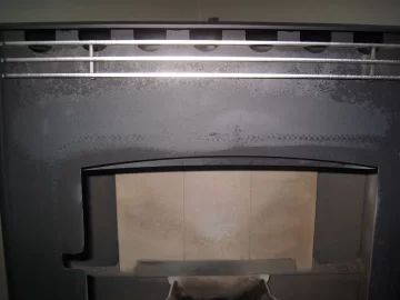

We bought our P61a Dec 2012. This past fall, we noticed more paint flaking off the front. It's now to the point where most of the black paint from the heat exchanger output down to the door has flaked off. Now some paint around the sides of the door is flaking. I've only seen this happen to a stove twice this badly. Once was on an overfired wood stove (not me) and the other was on a stove where someone (also not me) used paint that wasn't high temp rated. I've been working with my dealer on this, who has been working with Harman. Today I got the call that confirmed true cause. For a period of time, some stoves were coming out of the factory with paint that was not high temp rated, and thus the flakes. So if anyone else out there runs into this issue, check with your dealer. My stove was manufactured July 2012.
Kudos to my dealer - Heartline Stove Shop in Jaffrey, NH - and to Harman - for making it right. At the end of the heating season (my choice - they would do it now if I wanted) they are going to pick up the stove, have it sanded and completely repainted with the correct paint, then bring it back to my home and reinstall it. That's great customer service.
EDIT: attaching pic per request. [Hearth.com] Harman paint flaking - true cause found
great job finding out what happened do you have any pictures of the flaking paint? I have a Harman insert and there is a few paint spots flaking off but its only like 2 or 3 spots nothing to bad. My stove was manufactured earlier and think its not the same thing but checking into it. It was never overfired or repainted I think something just hit it and chipped the paint but just wanted to check thanks
