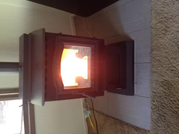

The new (replacement) stove will be installed Thursday (August 28th)!
New (replacement) P68 was installed today! Did an hour long run for paint cure, etc. with open windows/doors. Slight production changes compared to older version - no hopper safety switch, hopper lid handle style, ash drawer door handle, control panel decal with color coding. The burn pot format looks identical. Still need to install hopper extension, remove rear panel OAK knock-out, attach OAK, clean-up the hearth area, etc.
