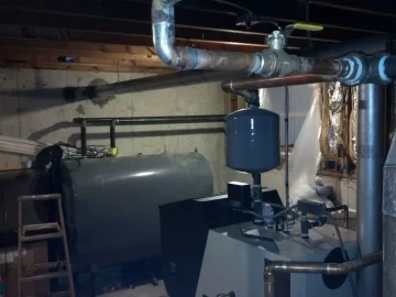

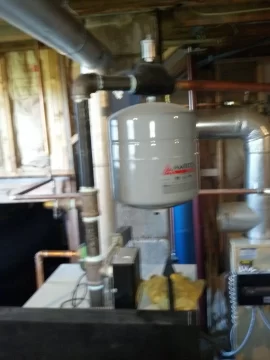

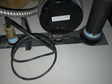

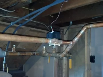

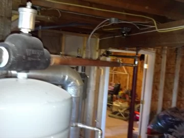

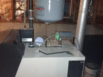

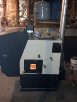

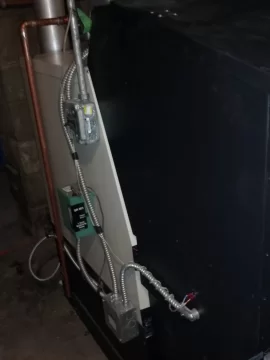

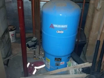

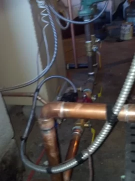

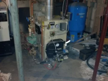

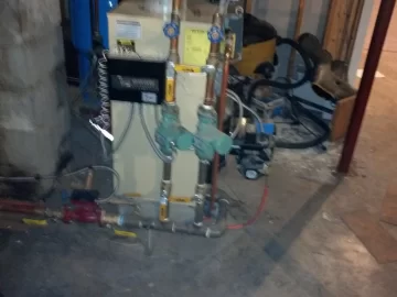

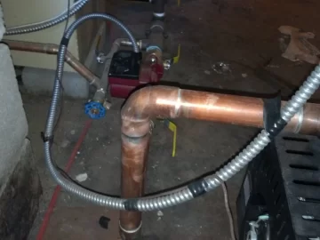

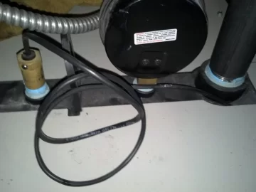

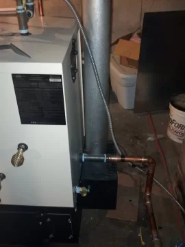

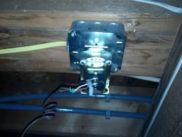

So....One thermostat and one pump on the old boiler?
A picture would be worth a thousand........ :)
Flash worked good

Tough to see what exactly the piping configuration is from the pictures.
What operates the zone valve? Is it connected to your oil boiler or the pellet boiler?
