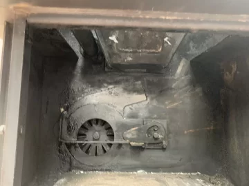

Unplug the stove….The igniter is inside the burnpot, there are 2 wing nuts underneath that hold a small access plate on, when you do check it(my guess is that it’s packed with ash). Also check the fines box, it’s up under the left side of your stove, you may have to take the rear skirt off….it’s been known to create auger squeal when packed…also be careful not to move the horizontal plate about 2/3 the way up. I just vacuum mine with out touching it after the plate is removed

Please disregard the photos of the burnpot on mine previous post. Maybe this video will help.

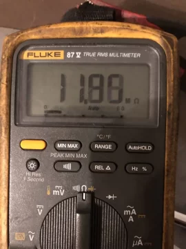

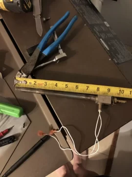

Anyway I finally got a bit of time to look at the stove. I located the igniter and took it out. It looks good visually. I ohmed it and got a reading of 11.8 Mega ohms. That anywhere near correct?

I believe my igniter is bad. I tried to let the stove light itself again this evening. I set a timer and walked away for a bit. I let the thing run 15min. It did not light. I don’t see any discoloration of the pellets around the igniter port. The igniter light is “on” on the control panel as well

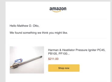

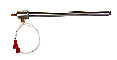

Yes,unfortunatly Amazon and others do track our stuff,also happens to me.That looks like a good price,they are expensive for that unit,not like the cheaper igniters other Harmans use.
I have dealt with these people,they are pretty big--ESES. And they have it cheaper,and they also sell an aftermarket one, which I would not be afraid of.
