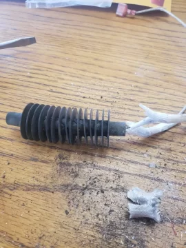

hi, P61A here but same parts and inards..
my ignitor crapped out few yrs ago starting with blown fuse....
ignitor was not shutting off and somewhow it affected the control board....actually it was reverse as the board was not shutting off the ignitor..
pretty sure that is the case in your situation....
note: there is a part on the board called a trid or triac which controls the ignitors off/on sequence..
in the end i had to replace the board but i did not buy the cheap ignitors sold on Amazon..
not saying you did but i bought OEM from pellets stove parts web sites along wth a new board..
pix of ignitor below.
btw: if that part on the board is bad, everything else on the stove will work normal Except Ignitor will not function.
