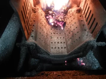

Morning shot of the stoves current pot setup for pellets and corn blend up to 50%. Feed rate set at 2 because currently burning 50% corn. At this blend no burn pot reflector plate or stirrer needed and they don't last long when burning corn as it gets pretty toasty. [Hearth.com] Harman PC45    newbie questions

Thanks for the picture bioburner!

Do you recommend buying the reflector or the pellet grate? (broken image removed) (broken image removed)
The squared mitered look door is a newer stove. The brass and or iron handle is at the hilt and the bulk of the handle is wood. The picture I posted for you is the large holed tray and is good for up to 50 percent corn and is being run with the small holed combustion fan plate. If you go more than 50 percent corn the small holed tray will be needed to keep enough heat in the pot and the reflector cover will be need too and the stirrer rod with the end plate to hold it. Corn has a ignition temp that's about 200 degrees higher then pellets.
