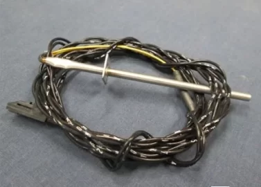

Status light on 8 year old Harman P61a blinks 3 short blinks when turning the stove on to stove temperature mode.
See video on youtube
Harman 3 Blinks on Status Light
Replacing the black ESP probe resolved the problem. See pic below
Has anyone fixed this error by doing something else? ? ?

Right from the Harman Manual:
3 Blinks: Indicates that the ESP (Exhaust Sensing Probe) has failed, has a broken connection,
or has gone out of range too many times. This requires a manual reset*
I would add: or a replacement.
They appear to be the only fixes.
I would add you might want to check to make sure there isn't an excessive amount of ash on the sensor. I read that cleaning this area and then resetting the stove might work.
Thanks for your comments, these are great answers!
The probe was really dirty, but since the stove is 8 years young (not old for a Harman!)
we just replaced it.
All mine takes is a yearly ESP cleaning. I did have a persistent three-blink problem earlier on and found that eliminating the surge protector cured it. No matter what flavor protector I tried it caused that problem.
