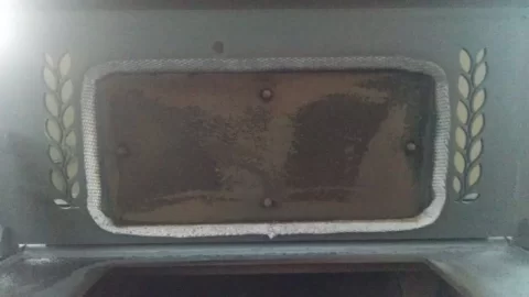

It appears the gasket on top door is leaking. Here are a couple of pictures. Notice the gasket appears discolored toward the top of the picture. . Also notice the soot on the left side of the picture (second picture), I sweep the top with a small brush after each reload to clean any debris that may have gotten on it when adding the wood. This stove was just installed last January, not sure how long it sat in the showroom floor.
[Hearth.com] Harman TL300 smoking [Hearth.com] Harman TL300 smoking
That is for sure at least part of your problem if that soot comes during a burn. Now that you mention it I have had smoke a few times after top loading and a small wood chip would hold the gasket up. I take the gasket and pull it down every few loads. This will also help to keep it tight as it tends to flatten out over time. Have you cleaned the back of the stove? This can only be done threw the top stove pipe opening. I find that can also affect your afterburner draft. I would ask the dealer to show you how when he comes as this is a very delicate area of your stove. Also have you checked the gasket on the afterburner damper. If you look at the owners manual it shows you how to check and adjust this damper. Mine needed to be adjusted after a few months of use and has been good since.

The bottom r corner of gasket looks funky kinda twisted. Loosen the acorn nuts and ease that to a better fit. Or take old one off and go to local hard ware store and get more gasket. Any spot that feels crunchy is leaking.
Just another thought is the top door flat or does it have a curve or bend in it as this could make it sit wrong also.

Razr I agree but how does he get a clean gasket print under the lid on stove top with creosote flakes on the side of gasket away from firebox. If I look at photos that's what I see?
Unless the backdraft is leaking enough smoke to build up soot on cut outs on stove top.
dont know, but why would the gasket outline remain clean? The creosote jumped over it to land on the other side?
