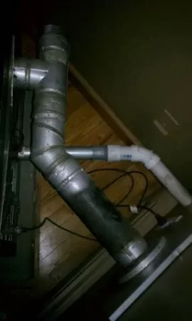

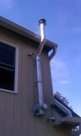

I was going to pretty much copy the way my stove piping is run now. The stove is kiddie cornered so the setup is as follows. T with clean out coming off the stove, 45 elbow with 2ft straight pipe through wall thimble. Outside of house is another T, 6ft straight pipe up to soffit, 2 90s around gutter, 2ft straight up with cap. My dealer recommended 45 up around the gutter instead of 90s due to restriction. Any comments, concerns?

My dealer wants me to come off the stove with a 45 and go straight out. No T inside. He is giving me a T that has a vertical and horizontal trap door so I can clean both inside and the outside vertical pipe. He is giving me multi-fuel pipe.
Oops I forgot that you had a stove already, and this was not starting from scratch.
I agree with the dealer, for you need to eliminate as many restrictive bends as possible, and I thought you mentioned using 4" vent which just by looking I would think you need.
1D

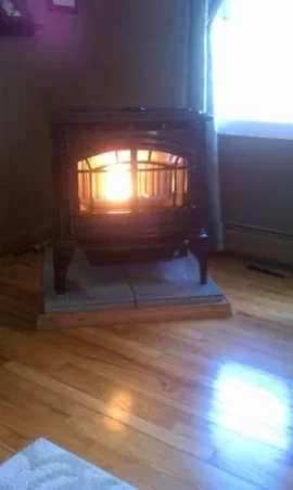

I will post some Saturday night. Perfect timing too because my Whitfield is acting up. Switching fans speeds on its own, not dropping pellets and shutting down. Its done this before and I ended up needing a new auger motor. I can't believe its doing it again. I just replaced the motor two seasons ago. I'm telling ya, its the worst stove ever made. Cant wait for the Enviro!

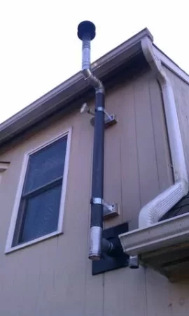

Make sure you have some strong backs around to help!!!! It took four of us to hoist mine into position. I do believe it is about 400 pounds and my dealer left about 40 pounds of pellets in the hopper after seasoning it for me. Great choice and you will love the heat from that stove.
Very nice indeed!
I like the dual clean out.
Congratulations, and enjoy. :coolsmile:
1D

I know! 65 deg today! But oh well, its still gonna be cold at night for awhile and I needed it for next year anyway. The Whitfield crapped the bed again. Gonna fix it and put in my woodshop!
