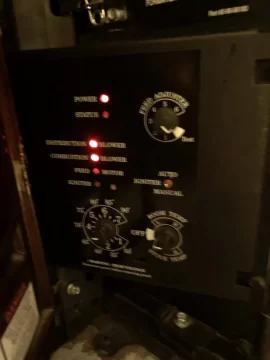

I have an Accentra insert and the pellets are not dropping. Auger doesn't spin and the feeder light does not display anything. Distribution blower light is also not on. Combustion blower light is solid.

Just did that. [Hearth.com] Harmen Accentra - pellets not dropping Everything looks like it's working fine except the feed motor and light. It's completely dark.
