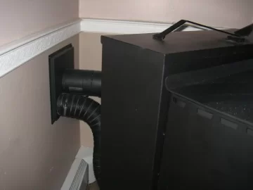

this may seem silly or brilliant but it works..[got it from a tip last winter]..
I take a long flexible 4" wide chimney cleaning brush[ the kind u would attach to a drill gun etc] and after removing the outside exhaust bottom cap shown, I brush back towards the stove to the inside..
it's a 90 elbow there and any stuff falls straight down behind the stove as shown.
. I then go from the inside with my long vacuum hose past the ESP probe in the tunnel and suck up the crud that I just pushed in from the outside... this way I know I got the elbow cleaned good without dis-assembling any exhaust piping.
