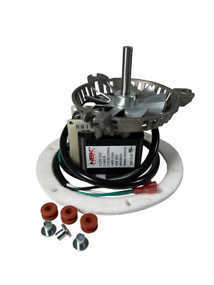

Makes me wonder if there is a gasket that’s finally worn out? But I believe the xxv just has metal on metal with the wing nuts. I added a picture for extra context.
This is the part itself. I run it outside the chamber and it sounds great. Once I put it back in, it’s terrible..

Alrighty. So when I hold the combustion blower, it makes no noise in my hand. The fans spin. Sounds great.
If I rest it down on the a lip of the stove and plug in - The section behind the front propeller blades rattles. More or less replicating the sound.
