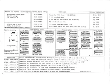

I will do that today, thanks very much for your help so far, any idea where i could find out factory settings for the dim switches?
Maybe this can help
  • [Hearth.com] Harmon p38
