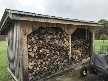

It’s pretty simple. Overbuild! You can’t skimp too much on the floor system, 2x4’s won’t cut it!
Here’s one I built at our last house. It held about 6 cords.
Nice. I'd have to learn some skills to do that. Perhaps version 2. What did you use for where it contacts the ground?

6”x6” posts with 2x12 floor joists 16” on center. Then 5/4 treated deck boards with an inch and a half gap between them for air flow. It would be a lot easier to not use a floor system if you have flat ground. This terrain was too sloped where I wanted to build it and I also wanted air flow all the way around.
Regarding the overhang... the longer the better.. my front is 18in and i could have gone bigger.. dont be afraid to do a nice overhang on the sides also. My back faces north and has protection on it so the overhang is not quite so big. The pics are what i have in my phone and dont show the overhangs super good
