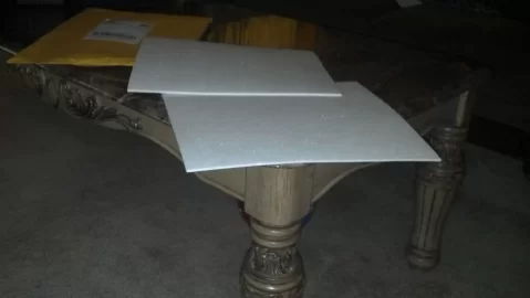

I bought these sheets of Lytherm off of ebay.. You have to trace the old gasket. But I got 4 sheets for the pice of 3 combustion blower gaskets...
