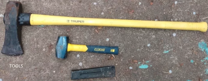

Show us a picture of your tools and the round your trying to split.
I use that block for small items. I have a very short/wide oak piece for the bigger stuff (not pictured) or I just do it on asphalt.

That Collins 12 lb is a remake of the Monster Maul. I have one and it is a great maul. But the 8 pound Fiskars is better.
What is the weight of the maul you have?
As I said above, yes you need a real sledge hammer.

If you can’t pound that wedge with the back of the maul it’s not worth the effort or expense. If you must get rid of it. Drill a line of 1/4” holes or use a hand saw to start the wedge 2-3” from the edge. If it has knots you might not be able to split it by hand.
