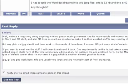

Well, I guess if anyone wants to see the drawing you will have to let me know. I drew it in Microsoft Word but cannot upload a Word doc, nor can I upload a jpg or a tiff file so I do not know how to get that file uploaded here. Let me kow if anyone wants to see it.
jpegs should work fine, unless the file size or image size is too large. What happens when you try to post? For instructions, read the sticky note at the top of the Pictures forum for instructions on posting pictures.
Going from a 1 cu ft stove to a 3 cu ft stove could put you in the opposite situation, especially if the 1 cu ft was producing adequate heat, just not burn times. How many sq ft in the house? Is downstairs a daylight basement or is this a conventional 2 story house?
I reread the picture upload process in the picture forum and tried unsuccessfuly again.
Here is the error message:
Error Message: The file you are attempting to upload has invalid content for its MIME type.
I created the drawing in Microsoft Word. I then copied the picture into Adobe Photoshop 2.0 and saved it as a jpeg file, and also as a tiff file, and then tried to upload it.
I had to split the Word doc drawing into two jpeg files: one is 32 kb and one is 42 kb so they are below the 350kb max.
Any thoughts?
Well, without a long story doing anything in Word pretty much guarantees it to be incompatible with normal stuff.....all kind of malicious codes can be embedded in Word and MS stuff, and also MS tries as much as possible to make it so their created stuff is only read by other people who buy software from them.
But any plain old jpg should and does work.....thousands of them here. I suspect MS put some kind of code in there.
If you want to email me the stuff, I will clean it and send it back. One way to easily do this is just take a screen shot of your pic and then edit that if needed. I upload screen shots here all the time without any editing at all, for instance the one enclosed here. On the Mac (and I suspect in windows also), you can set the type of default screen shot - in my case it is png which is another allowed graphics format.
jpg, gif and png work here, tiffs are usually too large and are not really part of "net" standards.

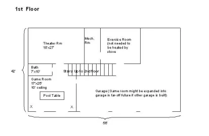

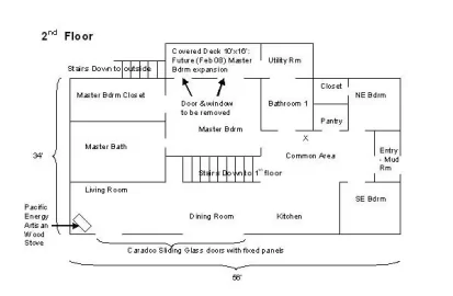

"x" is where I could add a stove, or move the Artisan. I think moving the Artisan to the 1st floor and getting a larger stove for the 2nd is the way to go. But, I am getting comments the Englander 30-NC might be to big to replace the Artisan with so maybe the 13-NC is the way to go (the 13-NC has a slightly bigger firebox: 1.9 vs. the Artisan's 1.4 cu. ft.)
Each bedroom has a ceiling fan, as does the living room. Currently, we have the living room fan on the summer setting and each bedroom on the winter seting, but I have not noticed a big difference in the bedroom temperatures.

I do not want to be the bearer of bad news but your stove is as far away from your bedroom as it can be.
what is your stove sized for as the sq ft of the upper floor is about 1700 so it would take a fais sized stove and 1 cubic foot firebox seams too small to me but I am used to old non EPA stoves
I agree about the stove being about as far away as it can be. So, would a different stove work or would it be better to move the upstairs stove more to the center of the house, between the bathroom and the pantry?
And, if I move the stove to the center, what would be be the best solution to the hole in the ceiling and metal Pro-Panel roof where the pipe used to go through? The ceiling is tongue & groove red cedar, which I guess I could splice new pieces into it, but then that would leave the actual roof with a hole in it. I guess I could just leave the stack sticking through the roof unused. Hmmmm...
If the stove can legally and safely be installed in the common area location marked with an X it will work pretty well as a heater for the floor. Not perfect, but with the use of a small fan it might work very well. In addition to the Englander, I would still consider the PE Spectrum or Classic. It has an exceptionally long burn time. You might also want to look at the Quad 3100 and 4300 in your search. They are exceptionally clean burning stoves as well as being good heaters and the 4300 is a nice size with a 2.4 cu ft box that is harder to find.
I also was thinking the location upstairs with the "x" in the common area might be a better place for the stove. I will look into the other stoves you mentioned.
As for downstairs in the game room where I have the 2 "x's" next to the pool table are really the only places I can put the wood stove as the floor above has radiant heat pipes in the floor (boiler uses a lot of propane and at $2.52 per gallon...I like my free wood). The radiant floor prevents us from putting any pipe vertical through the floor. Both locations will have to be vented through the wall and then can go vertical.
However, the "x" to the right of the pool table has an overhang (deck off the 2nd story) of approx. 8' above where the pipe would exit from the wall. We could go up through the deck and then enclose the pipe (chimney?).
The "x" to the left of the pool table will also have to go through the wall and then go vertical but at least I would not have to go through the deck.
So, to finally answer all my questions about the location of my stove(s), I guess I need to know the following:
1) Does the pipe from the 1st floor location need to go all the way vertical to above the roof height? I would think it does but I believe I have seen gas stoves vented out through the wall and not have a pipe go up to above the roof line.
2) If the pipe does not have to go all the way above the roof line, can I have the pipe exit out under the 8' overhang? The overhang is covered in stucco and if that is not fire-retardent enough I could always cover the part of the overhang by the pipe exit with another type of fire-proofing.

Sorry, I don't like it. That tall exterior pipe is going to draw poorer and need a lot more cleaning. And having a wood stove next to the pool table sounds like a prescription for an assburn. Maybe consider a pellet stove in the lower part of the house? Or if wood is plentiful and easy, maybe consider a wood boiler add-on and scrap the upstairs stove idea?
Yeah, getting your butt too close to that stove would not be much fun.
