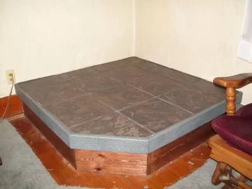

Very nice! I trimmed mine in pine 1x4.(raised hearth) Then painted it flat black, and over that painted it with a product called Stone touch. It's a paint that looks and feels like stone.(textured) We are putting in a Hearthstone Tribute and I am praying that the grey will match the stone in the stove. Anyway, the finished look is very nice. I would post a picture, but it's still in the camera and my wife is the one that does all the work with the camera. (read, I don't know how, it's a technology thing) :red: It is my understanding that as long as you have met the distances for clearance to combustibles, you can trim with anything you like, or are able to work with.

Thanks. I'd be interested in seeing a picture when you can get it posted.
We'll see if I can figure this out.
guess not I'll keep trying
OK I think I have it this time! :-S
:wow: It worked!!!!!!!!!! And it only took me several hours!!!!! This is a work in progress. The rest of the carpet is coming out, and the floors are to be redone next spring. The paint on the trim got scuffed up when I was laying the tile.(yea... painting before I laid the tile wasn't the brightest thing I have ever done. :red: ) Anyway this is the hearth, the stove will be put in Friday, and burning by the New Year! ( we hope! )
Looks like we have similar taste in tile!?
