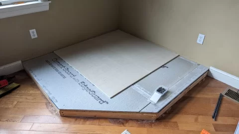

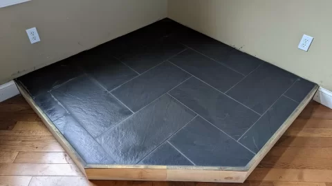

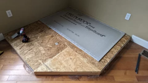

I had basically the same plans/need. I needed to get to an R-value of just over 2. I built a 2x4 frame, then OSB, durock-micore-durock-porcelain tile. Based on the ratings from the companies, I should be at just over 2. Regardless, I have a feeling that the new hearth is better than the old one. Here are some photos of the build.

That will do well.

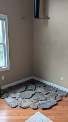

Some lumber yards and builder supply places can order it if not in stock. Check if they are a USG dealer.
Fiberfrax Duraboard also can be used.
