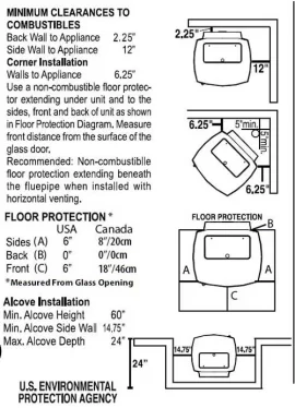

looking to get the Harman Accentra.....question about the hearth.....the sales pearson told me according to NYS code the hearth must go out 18 inches in front of the stove.......i know as far as wood burning stoves she is correct....as far as pellet stoves i dont believe she is....i have a call into the Building Dept....waiting for a answer......does anyone know how far the hearth must come out.....it doesnt have to be NYS code...just trying to get some ideas of different areas...

Tell her to look at the UL label on the back of the stove. US installation requires 6", Canada requires 18" (which IMO is a bit silly for a pellet stove high up on a pedestal).

A quick look at the Accentra owners/install manual ( P. 2) shows that you need a minimum of just 6" in front of the stove, measured from the front glass face.

For mine it was 6" from the face of the door glass to the edge of the hearth.
