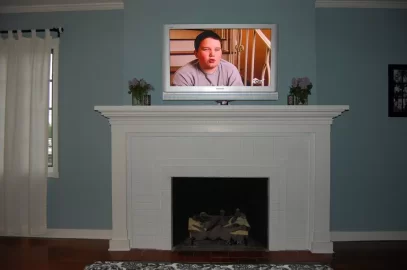

Here is a breakdown of the nearly complete remodel of our hearth and I thought I'd share. We will be putting the liner in later in spring when I can get on our steep roof, but I wanted to slide the Buck in, and maybe the bigger factor was my wife wanting it out of her laundry room.

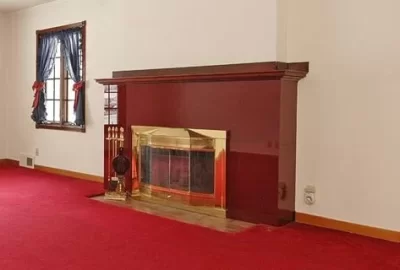

1) The Start, AWFUL red and gas fireplace)

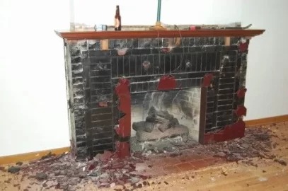

2) Tearing it apart. Lots of beers spent on this and I hate construction adhesive...

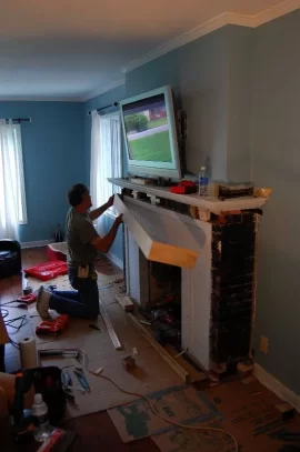

3) I can't take all the credit for the mantle wood trim, my father in law was a HUGE help on this
4) Overall mantle trim done, break for a few months...

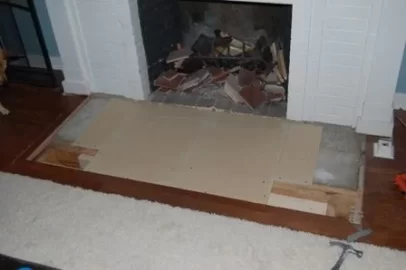

5) Heath is remodeled and extended. Here is with the layer of Micore going down first.

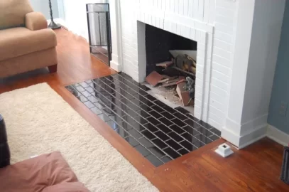

6) Cement board is overlaid and tiling is in without grout.

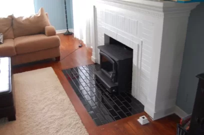

7) Grout is added, wood stove is put in. The trim panels will be mounted after final install of the liner. Wood mantle base wood trim was taken out of new tile and will be reinstalled shortly, also a new layer of paint where the new grout met the brick.

One question maybe someone can help out with: Do I have to install the trim kit for the stove? I like the way it looks currently and once we trial fitted the black metal on the mantle it looked OK, but we preferred the look of just the stove. In both cases I'll be using a top block off plate and full liner, but without the kit I also think I'd have more surface area of the stove exposed to the room.
The unit can be used as freestanding also with the leg kit, but in the instructions when describing the unit as an insert it only list the surrounds as an option.
You can leave it like that without the panels, I think it looks good the way it is, probably because the fireplace is smaller and its white, not sure but it looks good.
I took the panels off my Olympic this year. Just make sure your block off plate is tight so your energy does not get sucked up the chimney.
Thanks for the replies. That's what I was thinking also, it looks much better without the panels and as long as the top block off plate is sealed really well, I think I'd actually get more surface area in the house.
I also called Buck Stove directly and they said the same thing. They added to make sure the top of the chimney was sealed well around the rain cap (which I planned on doing also) but I'm not sure how that would affect anything down below. Either way, glad they agreed too.
Now to figure out what to do with the trim panels... I don't have the box and there is a VERY small scratch on one... I guess Ebay maybe.

I wish the picture of the demo was larger but it was from a camera phone. It's amazing the difference from when the construction adhesive and chunks of tile were still attached to where it is now.
It's also hard to notice, but there was a 1.5"x11"x7' piece of hardwood added to the top for more depth and adds to the overall size of the mantle.
I noticed the thicker mantel top and agree, it looks much better. What's the white box in the floor in front of the right side of the fireplace?

Last thing I'll mention was the PITA the plasma install was. Behind the plaster (not drywall...) was brick for the chimneys. The down stairs runs left, the one here runs slightly to the right. In the middle? I have no idea. Nonetheless it's concrete and that's what I had to anchor the TV on. I ran 5 anchors that could support 150lbs each... (run each about 6 inches into the concrete/brick.) I could have probably done 2, but it's just the idea of a 80lb plasma on the wall with kids running around that scared me. Before hanging the TV I climbed on the wall from the bracket and it didn't budge a millimeter. The wires for the TV were also run through the side of the mantle behind the wood and to a cable box downstairs with remote eye. That's the black box on the top of the mantle. I lucked out on power, there happened to be a plug on the top, talk about lucky in a house built in 1949.

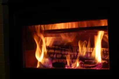

First burn for the 74 and for the year, I'm smiling ear to ear although the room is a bit stinky.
