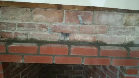

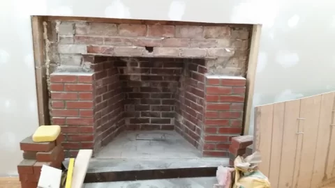

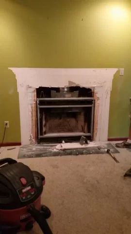

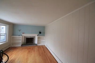

Looking for help/input on a hearth renovation. My wife and I are planning on replacing the wood paneling that surrounds our insert with stacked stone.
The paneling exceeds (barely) the maximum facing thickness requirements in some places (the thickness varies a little). The requirement is that it protrude less than 075". It is as thick as 0.875". For now, I am shielding the wood where it exceeds the facing requirement with some leftover liner insulation. I have monitored the wood temp with an IR gun, and it seems to stay below 130 (usually well below). However, I want to get my installation up to code. Also, my wife and I really like the stacked stone look.
I have a hearth extender in front of the stone hearth. I would like to tear out the current stone hearth and replace with one of adequate dimensions.
I am looking for recommendations on stacked stone, as well as general advice on this project. I haven't done anything like this before... but the youtube videos make it look so easy :) Is it really as easy as the videos make it seem?
For those of you who have done a project like this, what stone did you use? Are you happy with how it turned out? Is there anything you would do differently the second time around? If you have a picture of your hearth ready, I'd love to see it!

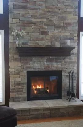

Here is a pic of our hearth, and also some pics of hearths that we like.

It is an insert (Enviro Boston) in a masonry fireplace. Can you help me to understand why you think this is too big of a job? Not saying you're wrong, I just want to understand. I will get a better pic when I get home from work.
The pictures I posted of what we're looking to do are probably misleading - I couldn't find a picture that showed exactly what we want to do. We do not want to raise the hearth. We want to do the following:
1. Tear down the wood paneling from floor to ceiling behind the stove, but not behind the bookshelves (why would I have to remove this?). Replace the wood paneling with stacked stone
2. Tear out the current stone hearth, because it is not deep enough (hence the current hearth extender). Remove some of the wood floor to make room for a deeper, but still flush with the floor, hearth

Do you know what’s behind the paneling now? It’s probably just more brick? If so cleaning those up might look good too.
Either way, knowing whether you’re veneering over brick or a wall board would change the installation I imagine.
Assuming it is an exterior chimney? Looks similar to what mine looked like. There should be brick behind it. If you haven't done brick work or stone veneer you wont know how much time is involved. It's not rocket science but you want it to be level and straight. The spaces for the mortar need to be even or itll look ugly as work up. I wanted to go to the ceiling with stone veneer but that would've been out of my price range. I got my brick free from my shop so all it cost me was mortar and my time. I also used a demo saw to cut everything.

Unfortunately I don't know. And I'm not sure how to check without removing the paneling.
I'm going to be taking 2 weeks off of work in about a month, and would have a good chunk of time to devote to this. I will also have help (family in town) for a week of that time.

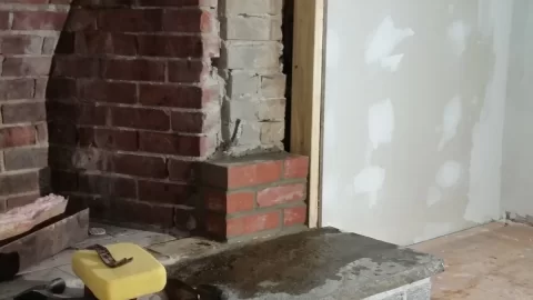

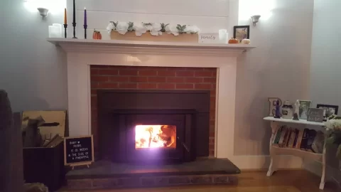

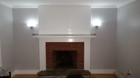

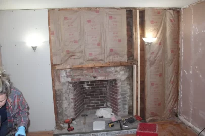

This is a few of my build. I had to repair the chimney area of the roof when I bought the house. When I ripped down the paneling I had damage to the frame. As you can see I ripped off the face bricks that were painted white. There was brick behind it. I built a veneer exactly where the old painted brick was.
[Hearth.com] Hearth Renovation [Hearth.com] Hearth Renovation [Hearth.com] Hearth Renovation [Hearth.com] Hearth Renovation [Hearth.com] Hearth Renovation [Hearth.com] Hearth Renovation [Hearth.com] Hearth Renovation

As long as the paneling isn't one piece running behind the bookshelves it won't be as complicated. It depends on how the carpenter built them in there. If you have plenty of time and patience as well as all the right tools you'll have a grand time.
The hearth extension may be a challenge depending on how big you need to make it. You may have to make it wider as well as deeper. I'd go the full width between the 2 bookcases. At minimum you'll cut the finish hardwood and remove it down to the subfloor. Then put down a sheet metal plate over the subfloor sealed along the edges with high temp silicone, cement board over that and then tile or something you prefer on top of all of it. You may want to check and see if your stove requires a certain insulation value for ember/hearth protection.

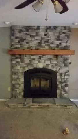

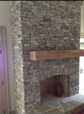

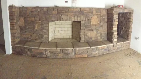

These are 2 that I have pics of. Both done with dry stacked ledge stone with some field stone mixed in.
View attachment 240803 View attachment 240804 View attachment 240805 View attachment 240806 View attachment 240807 View attachment 240808 View attachment 240809
Looks beautiful, thanks for sharing the pics. What do you mean by "I had damage to the frame?"
Those look great! I especially love the one with the curve.

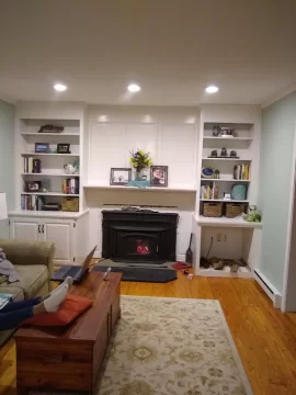

Unfortunately it looks as though the paneling does run behind the bookshelves. Is there any type of saw I could rent that would allow me to cut along the edge of the bookshelf?
Do you think it is doable in a week, if I devote a full week to it (I won't be going into work)? I will have at least one other adult to help me, who has some masonry experience. I know it's hard to answer this without knowing my DIY skill level... but I'm just looking for a rough understanding on whether it is achievable in a full week of hard work, or if I'm not going to come close to getting it done, and should expect it to drag on for a while?
