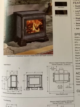

I think the Hearthstone Homestead would work....?
Are you aware of any others? I want to maximize firebox size. The Homestead comes in at 2.0 cu ft. My 1101 insert is 1.7, not enough difference to justify $3k.

If choosing the Homestead, the 6" legs will work with a 25.5" flue collar top height. That config has much lower hearth insulation value requirement of R=2.5. The 4" legs require R=6!
