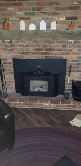

Hey guys. We had our wood stove insert installed and the sweeps noted that the hearth was too short for code. It only extends about 7.5" beyond the front of the stove insert.
I believe code is 18" right? How would you extend a hearth like mine, that is raised and brick? I don't think the hearth was 18" even without the insert...
Appreciate the advice. If it matters, this is in our lower level, on concrete slab. The floor is vinyl plank and there is only concrete under it.

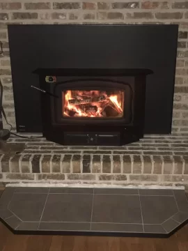

Get a hearth extender. Many websites sell them. They run between $200-$500 depending on what you choose. Without one, I would think that wood flooring is gonna get awfully hot. I don’t know what kind of stove you have, but i would check the clearance on that mantel also
