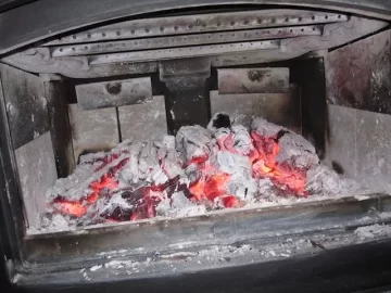

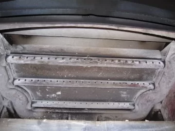

Here are some pics of the baffle that sits right above the secondary burn tubes. There is a small lip - about 1.5 inches that goes up toward the top of the stove just above the burn tube closest to the door.
You should be able to feel the baffle between the tubes... I've bonked mine a few times with logs and it sort of reminds me of rigid styrofoam or extruded foam insualtion with a skim coat of concrete on the outside (!?). I have taken a couple of little dings out of the material.
Hope this helps!

There won’t be any steel up there, it’s cast iron

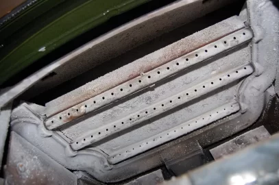

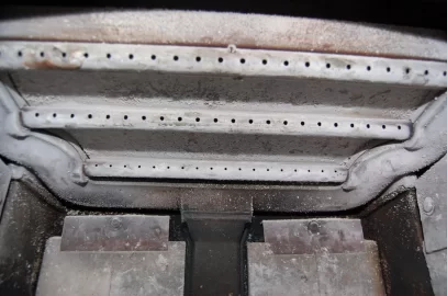

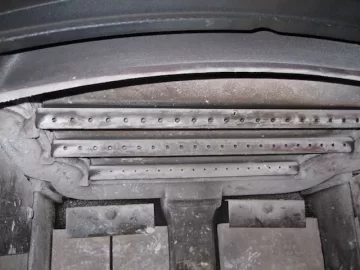

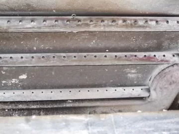

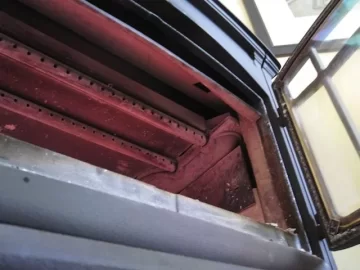

Here are some pictures. Note my baffle is all black. I got frustrated with the pictures because everything looks white or grey. And the heat from the coals made it difficult to say there. It's quite black up there. Flash made it white. My pictures aren't as good as VTHC. I haven't done the nail test yet. I will this weekend.. PROMISE! And I didn't see any dings. But here you go. Also, I was comparing the cut on the edge, if that had any implications.. Thanks Vixster

Looks as though there is something resting on the tubes. If so, that would be the baffles. Can't imagine anyone putting anything else there. If there were a space between the top of the tubes and the underside of the top casting, that would look different (from what I can see in the photos).
Don't worry about the baffle. It is not nearly as fragile as you may think. It's quite heavy and dense not like a chunk of styrofoam, should be a half inch thick. You can poke it with a piece of kindling, thwack is with your finger, or scratch it with a needle. To break it you need to seriously thump it with something. Mine is very white though. If I am burning poorly, it will get black until I get a hot fire again. Since your fire looks hot, I can't imaging why that baffle looks so black.
I would be happy if the company put out an unbreakable baffle of some sort.
The baffle in my Shelburne was black when I bought it this fall. I think it was overspray from the stove being painted. Maybe they started installing the baffle earlier in the build-process. Either way it is difficult to tell from your pictures for sure but I would say it looks just like mine. Mine, however does feel like fiberboard and is easy to distinguish.
Argh... mine does not feel like fiber board.. feels solid like cast iron... will do nail test later.. I know my pictures stink.. BTW there is a large gap between so called baffle and roof of stove... like 1-1.5 inches...
You know, it almost looks like you have a tray that the baffle sits it. I wonder if you took the top off, would you see the baffle sitting on the other side of that metal?

You are fine. Based on the pictures you posted you have a baffle. It is sitting on top of your secondary burn tubes (just like my stove, and Dan's). The reason mine is white (ish) is residue from my overnight burn. I believe initially the baffle was a darker color when i first got the stove last January. The description of the "feel" is based solely on me bumping the baffle with a small round, after i realized the material was not cast iron or steel (like the tubes).
The gap at the very front is the opening for the smoke to get up your chimney, so there should be some space between the baffle (above your secondary tubes) and the top of your stove so smoke can exit the fire box.
Are you getting good secondary burn when you lower the primary air? If so, your stove is running like it should... W/out the baffle i don't think the secondary system would be very effective (no secondary flames).

I may have misunderstood your posts. If you have something sitting on, or almost on, your burn tubes, with 1" - 1 1/2" above it to the underside of the stove top, that is very likely your baffle. I somehow got the idea you had 1 - 1 1/2" space between the burn tubes and the underside of the stove top, with nothing sitting on the tubes. Sorry for any confusion...
it's definitely between tubes.. I am just not sure of it's material! it's does NOT feel like "light weight" material.
well, after the stove cooled off for 4 days, I was really able to inspect the baffle. It very much is a different material. It already has a bunch of dings in it. It does feel thick. I was able to really feel it and move it (lift it). I certainly have a better understanding now.
