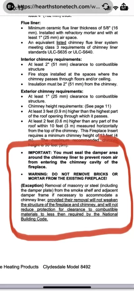

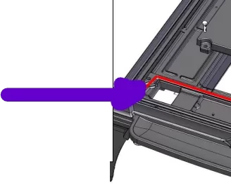

I too have many of the same issues. Did they install a blocker plate or seal around the liner in the damper area as per the installation instructions? See attached.
