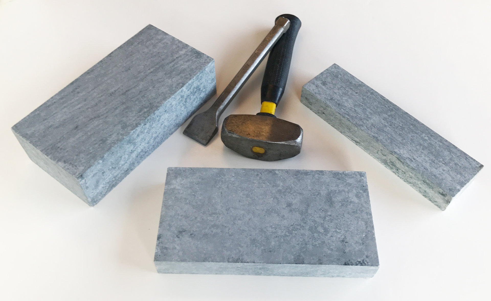

Perhaps these sizes may match up
(broken link removed)
And I know I have seen the retaining straps on a stove site, Woodsmans,Obidiah's or somewhere.
