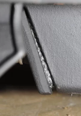

I will be hooking up my new Hearthstone Heritage in the coming week.
I noticed that the asp pan door does not seat very well at the bottom. It appears that the gasket at the bottom of the door doesn't touch the bottom of the ash pan.
My question is- will this effect the operation of the stove? It does not appear that the stove would draw air into it from this bad seal when the ash grate is closed, but perhaps I am mistaken about this.
I have heard complaints about the ash pan, and was not even going to use it. I was just going to shovel out the stove like I did for the past 7 years with my old stove.
I've posted a photo of the "bad seal", and would appreciate any thoughts on this. Thanks
Doug

I have the same stove, I just took a look at it and it has the same "gap". I did the dollar bill test and it's snug. My stove is new this year and I've only burned a couple of fires in it, but what I've noticed is if that door is open, lots of air gets in and the fire takes off. I've used the ash pan just because I wanted to try it, but I don't see it being something I use regularly.

The ash grate does not make an air tight seal between the firebox and the ash pan so a leak at the ash pan drawer will indeed be a leak into your firebox. I have never even tried using the ashpan since the little tray only holds about 2 cups of ash and has no lid or means of securing the ash during transport. I would be using it as a fancy shovel so instead I just use a shovel and fill a galvanized bucket about half full of of ashes each time. I let the ash pretty well plug up the ash grate during the burn season. If the ash pan was bigger, deeper, and had a lid I might consider using this system.

I have a Hearthstone Homestead that also only holds about two cups of ash....worthless! and yes you will get a good amount of draft through it. I solve the problem by filling the ash pan and leaving full. it stopped the draft problem qiut nicely, and I don't have to mess with the pan...

Oh and the bottom of the outer door seems to not close as tightly as the top similar to the first photo.

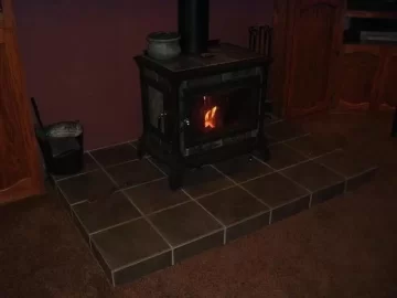

Yes, there is a rod that is laying in my ash pan. The rod attaches to a little tab that allows you to operate/open the grate. You must remove the rod before closing the ash pan door and if you forget to close the ash grate, the ash pan door pushes the tab as it closes which closes the ash grate. It might be a workable system if only the ash pan was much much more substantial and not hidden under the stove as it is. If you want to use it then go ahead but I have way more ash then that little tray can hold. Also, the stove is much easier to burn when there is a healthy inch of ashes on the floor. If I dump the ashes out from the bottom then there goes my inch.
[quote author="Hoopdancer" date="1222934791" Over all do you "Highbeam" and "Zim" (or other Heritage owners) like the Heritage? Would you have bought a different stove knowing what you know now after experiencing the good and not so good of the Heritage stove?[/quote]
I do not regret buying the heritage and especially not buying a soapstone stove. Realize that I paid under 2000$ for my stove brand new from a dealer before the prices went way, way, up. Given the price increases and my experience in this home with the heritage I would buy another soapstone stove that is as big, or somewhat bigger, than the heritage (for longer burn times) and I would likely go for a woodstock. Reason being the cat will allow for a longer and lower burn. I love the side door. I love the looks of the stone and the cast iron and the large viewing window stays very clean. I appreciate the tight install clearances. If the heritage takes a dump or if I move to a new home then I will go for a woostock, otherwise I hope to be burning this one for a good ten years.
