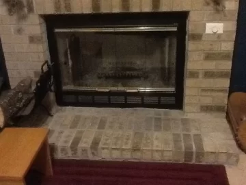

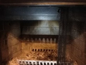

We could use a picture or two of the setup to be sure the recommendations are correct. It sounds like you may need a stove with a blower.
I will up load a picture this evening when I get home.
Still working on the picture guys....will get it up tonight I hope.
Ok guys here are pics of my current hearth and heatilator where the wood stove would be installed. I have 21 1/2" of hearth, which would work for either the Heritage or the F400, and 23 1/2 " to the bottom of the smoke shield on the heatilator, 25 3/4" if it can be removed. Can it be removed? Anyway, I checked, my installation situation would prevent the Phoenix or Mansfield from working.

This is probably understood, but just in case not, you do understand that you can't plunk a stove into a ZC fireplace. Some inserts will qualify, but not a free stander. You can put a free-standing, rear-exit flue stove on the hearth and vent it to a tee and up a liner, but you can't put a stove in the ZC fireplace. Are you considering placing a stove on the hearth in front of the fireplace (and extending the hearth)?
I mentioned this in the PM we had, but, does the Fireview fit in their? The Fireview rear vents.
I mention the Fireview over the Progress as this stove is suppose to only be for mild weather only. But, I think the Progress would fit as it can be rear vented and can have shortened legs to fit the opening.
Begreen, yeah, I know I can't put the stove in the ZC fireplace. It would sit out in front of the fireplace on the hearth, then rear vent back and up through the existing pipe with double wall pipe. I will take a look at the Encore and Fireview.

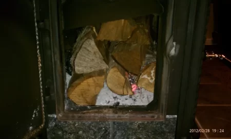

Picure is of my heritage loaded for bear.
Thundar-
My guess is that your current zc fireplace vents into a triple wall metal chimney. If your plan is to install a freestanding stove, I believe you'll need to rip that out and use Class A piping.
