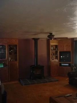

I have been burning non-stop since September 15th this year. Well, it went out once or twice while away for the weekend. I'm on course for about 6 cords of softwood consumed for the 07-08 winter.
My stove is top vented, free standing, no damper, vertical stack of 13-14 feet, 8 of which is class A and the rest is the double wall slip joint in the living room. 1700 SF home with poor insulation that requires constant btu input when the outdoor temp is below the desired indoor temp.
I fill the stove for the night at 10PM with 3 or 4 large cottonwood splits on top of whatever coals are left. I fill right to the tubes. Seriously, to the top. I have worried about bumping the baffle even. I keep the wood off of the glass though. Let it char at wide open throttle, then half throttle for a few minutes and then shut to zero by 10:15. Sometimes the flames get snuffed for a few minutes but they come back to a nice rolling secondary only fire by 10:30 which is beddy by time. The stove top might be 400 or 450.
Wake up at 6:30AM, stove is at 150 or so stove top, stir the coals, load on small 1-3 inch stuff topped with 3-5 inchers to the tubes and off she goes, I refill the stone kettle, and let it run at 70% up to 400 and then go to work. The wife keeps it running all day.
The cottonwood doesn't have as many btus as some other wood types but it does make some ash which covers up and seems to hold coals pretty well. I empty the stove ashes by scopping every week or so when the ash level is about as deep as the little inlet hole in the doghouse. Leave about an inch of ash or this stove is a totally different animal, it likes the ash bed.
So I get 8 hours of burn time but I do not get 8 hours of productive heating since the stove is so cool in the morning.
