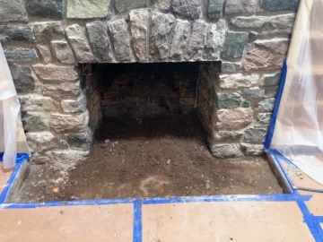

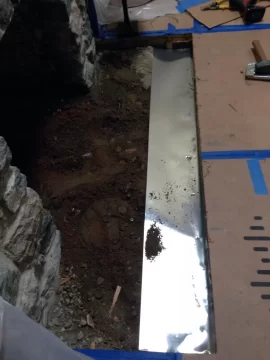

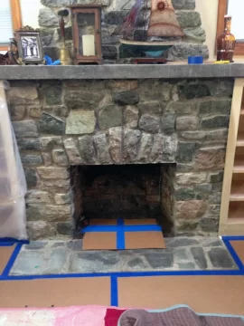

Here are a few pictures of the hearth work I'm doing to accommodate the Homestead. I realized that extending the hearth wasn't that big a deal since it will be flush with the floor and won't be a tripping hazzard. This will enable me to slide the stove forward a bit more into the room.
The old hearth only was beat up and only extended 16". The cardboard template in the fire box is a template of the Homestead.

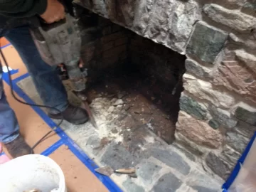

The entire hearth was removed in about 1 hour.

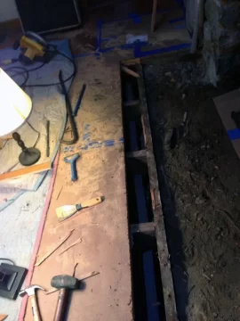

I measured 4" and eventually removed 6" of wood floor to give me extra room.
[Hearth.com] Hearthstone Homestead hearth mount install question

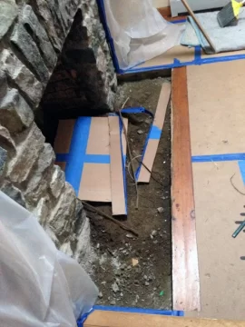

I don't have a picture but the wonderboard went down next.
Covered it up with 12" flashing to keep the cement in place.
What are you doing about the required R value under the hearth for the Homestead? It's over 6, and an inch of concrete is about .1
Also, I would honestly bring it out farther (the hearth) You need 16" (minimum) in front of the glass. Making it deeper now will allow it to creep out later..;)
The hearth will be 2" bluestone set in concrete which sits on the original pour, it must be 2' of cement and stone. The portion I extended I will cover with a hearth pad as I didn't want to remove more than 2 1/2" from the floor joists.

You say you took 2 1/2" off the ends of your floor joists. Did you do something down below to shore up the end plate and joists to compensate for the degradation caused by removing this much wood? Those joists are carrying the load of your entire floor. Not only are you compromising the joists by reducing their width, but you are going to be adding a lot of weight to them when you pour your concrete and lay your blue stone. I did some construction work earlier in life and I can tell you I've seen this kind of modification done before (plumbers are notorious for cutting up floor joists to run their pipes) and it can really cause serious problems down the road.
I used floor jacks and supported the joists along the front of the hearth which is accessible from the crawl space.

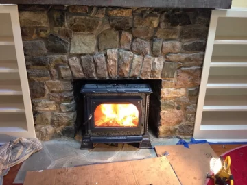

First break in fire yesterday![Hearth.com] Hearthstone Homestead hearth mount install question
