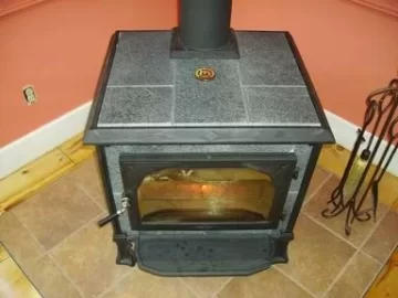

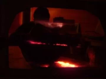

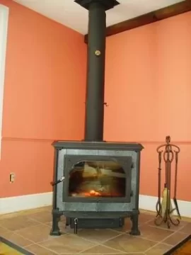

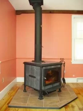

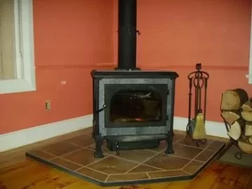

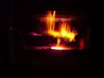

Sorry it has been a while guys. Work has been overwhelming lately. Now I have a lot of catching up to do!
I finally got the Inspector to sign off on it!!! Thanks to Enchanted Fireside working with Hearthstone and my installer John, with Colonial Millworks to guide him out of some old information that he was going by. He admitted that he was wrong and the installation should be done as outlined in the manufactures specifications. He thought my installer did a great job of following the guidelines and even going above and beyond in some areas. It took long enough but boy am I a happy camper now! Every moment I had possible for the first few days, my head was right in front of that stove adjusting this and tweaking that (driving my wife nuts). Thanks to the knowledge from you guys and this forum, "I do believe I have it down for a smooth operation". These Soapstone babies are truly different then my old Cast Iron was and it takes a real mental adjustment to understand that. You just see that flame going and going and the stone is barely hot. But watch out! Once those stones are hot, your worries are over. You have to think of every adjustment that you make to the flame, reacting in slow motion compared to the Cast Iron stoves. I really do love this stove. I can sit two feet away with the lights out and enjoy the show while my whole house stays very comfortable. It's that slow steady constant heat creeping around that does the trick. Then I ended up having to do some long hours at work so I taught the wife how to just put in one fat log if it gets down to nothing but hot coals at the bottom. That way when I come home I am assured that there will be a nice big hot coal waiting for me to re-stoke a long with a good draft. I can't say enough at how important it was to have that flu damper installed. I close that down 1/4 turn when the flu temp gets too high and the stove gets good and hot plus my wood lasts much longer. At night after experimenting I actually turn it half shut with the stove damper completely closed and it just keeps chugging away leaving me beautiful coals for the morning. I discovered in the beginning that my wood is really holding a lot of water. I now stack two loads worth near the stove and that made a world of difference. This stove seems to be a bit more sensitive and reacts strongly to damp wood. It really cools and slows everything down, unlike my Cast Iron was. But that is certainly not a complaint. Below I posted some pictures. I wanted to wait until I had it down and found that "sweet spot" for steady "Cruising Flame". I was amazed at how you get the coals at the bottom, the little flame on the logs and the secondaries up top. Now that is real efficient extraction of BTU's from wood. Now that I have the basics down I can share some time with my wife. But even being with her I still get to watch the stove together - so is that considered cheating?? :-). I'll read some of your posts tonight. Again thanks so much for all your knowledge and tips that led me to a quick understanding of the operation of this stove. She sure is a beauty.
